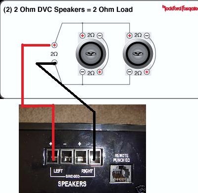

well look up versatility. and i actually have a bass reflex in my basement i will try it this is how its wired still think i will blow the amp?Upload

I don't recommend running those amps bridged @ 2 ohms. I actually had a p600.2 @ 2 ohms bridged (was using a 12" P3) and blew it in less than 5 min after installing it lol. The best amp I could recommend off the top of my head for your subs is a kicker zx750.1

An ideal amp would be one that does 800w @ 2 ohms (or 0.5 and 8 ohms). The only rockford amp that would work provide adequate power is be the p850.4. But the efficiency would be horrible, and it is a very impractical amp for a subwoofer setup.

I'm not sure what they put out @ 2 ohms, but I don't think you would get full potential. And yes I'm saying 800w rms because they are 4oow a piece.
You will probably keep blowing fuses running @ 2 ohm bridged. But it is still hard on the amplifier none the less.

The size will have nothing to do with how the amp performs. It's whatever impendance the amp see's that will dictate how it performs.
The T600-2 should work if it's 2 ohm stable bridged. Those amps are under rated as well so expect to see more power. Let us know how it works out.
