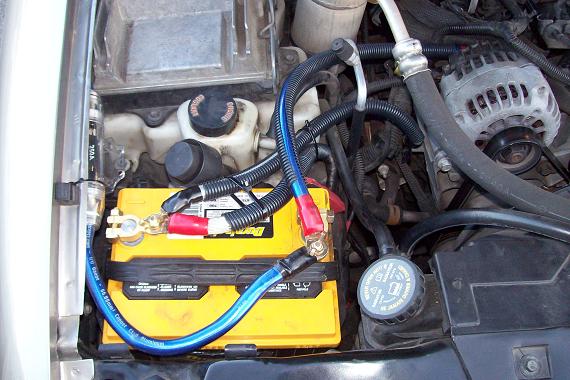

anyway, I will be taking pics and posting them as soon as I have the time, for those with the same vehicle.

pics:
Username: Snowball123
West Allis, WI
Post Number: 2253
looks nice, is that KLMX wire?
Username: Hittin1
TEAM REVOLUTIONLake Charles...
Post Number: 2551
any other batts besides the duralast? Nice job on the wiring. looks like a clean install.

Very nice example of a properly done big 3.

it's kolossus wire actually, it gets a lil bit less flexible after using a torch to soder the crimps, but it's still pretty good.

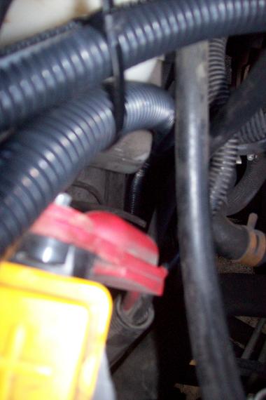

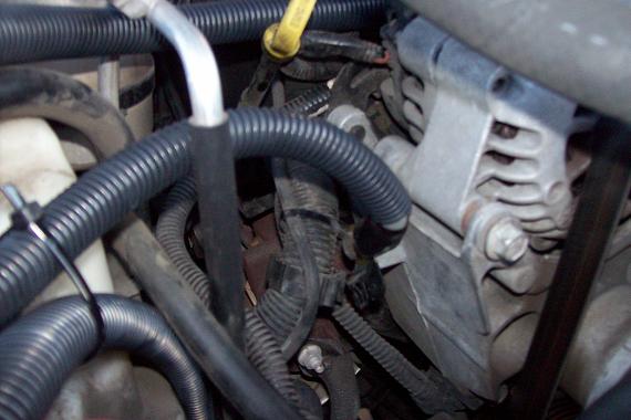

I bolted the alt bracket to batt neg if yall can see that.
thanks for the compliments, I hope I helped someone out here.
that last pic was for someone on CA, I linked this thread to him, he has the same vehicle as I do.
Mark, I just have the batt up front, I think it's 800cca

How is that power wire secured to the frame... would have been a good idea to loom that also.
Username: Jtown
Texas
Post Number: 3603
the power wire is zip tied to the existing wiring that goes back that far. I didn't have enough loom at the time, so it's loomed as it goes past the exhaust.
