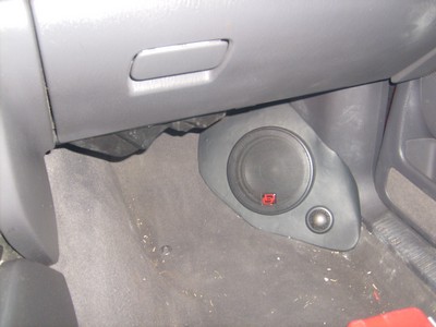

They sound alright, but need more power.
I am currently running the passive with only 75 wrms going to them.. I am looking for the right amp to power these and to run them active.

are those qlogic? They seem to fit well for off the shelf. How do the ound, besides the lack of power? Do you like the sound coming from below like that?
I knew I would step all over those if I had them in my car.
Nice eq install..
Username: Hittin1
TEAM REVOLUTIONLake Charles...
Post Number: 2393

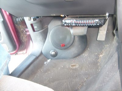

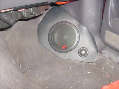

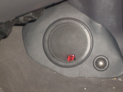

they are not glogic. They are custom FiberGlass(over mdf and bondo,ect) covered with black vinyl. Took forever because of the weather.
Wont be long till they get destroyed i'm sure. FTL.
As for sound. they can not be heard over the cadence comp set in door. I will need a bigger amp for them.

You know your hardcore when you cut your brake pedal to fit ur audio. LoL
nice job mark
