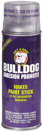

Username: Bernymac
Phnom PenhCambodia
Post Number: 4546
Registered: Sep-04
you could use adhesion promoter.
Username: Jtown
Texas
Post Number: 3419
what is that and what would it do Berny?
Username: Shortysetnies
Andrew Capps, NC US
Post Number: 3100
I do... I use Bulldog adhesion promoter. It makes paint cling to just about any surface
