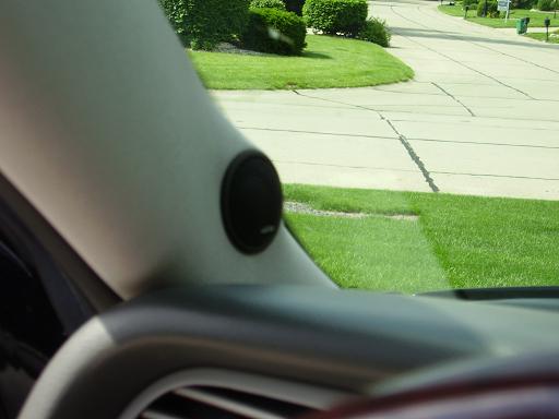

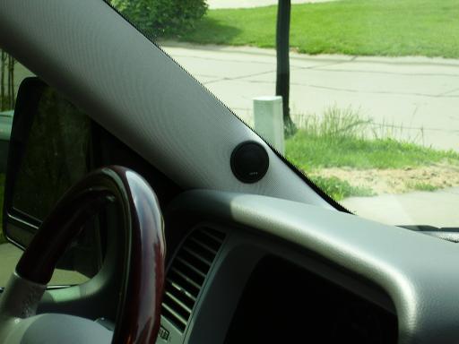

I like the A Pillars.
I fiberglassed mine in and then wrapped it in a mesh material that matched the interior.

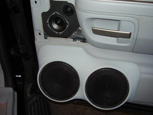

jake that looks really nice but no way i would do that. its to high man. i tried my tweets all over and right above my 6.5s sounded best to me.

Thanks for your expertize BLK but i actually have a tweet down low as well. To tell the truth my front stage system probably took longer to tweek/phase than your entire system did so be careful before you jump to conclusions.
