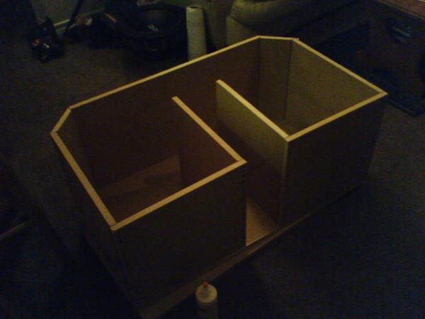

you said earlier 58" inches of port .. you did not mention that was the PORT AREA ... and thats not enough for a 5 cubic foot box
minimum i'd run in 5 cubes is 80 square inches

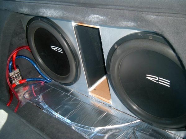

i would turn the subs/port and fire them directly into the cabin..
build the box big enough to almost seal it off from the back of the trunk.. have the seat folded down and subs/port firing through
sub on each side and port the middle .. design the box so that whatever the width of the port is.. is would be that same dimension from the back of the box.. this way you have a straight port.. not one that looks like this
_| |_

in the end the corners ended up being 30s instead of 45s since i fiberglassed all the seams.. thicker on the 45 joints to round off the back edge more

that setup i showed you was two RE SX 15"s on 3600rms.. would burp a 151.6dB @ 49hz on a TL out of the trunk
best bet to get trunk cars loudest is seal off the trunk away from the cabin having everything fire in.. the less volume you have the louder it is going to be.. if your filling up the trunk and cabin thats a lot of volume vs just the cabin
you could fire two 15s forward.. they would need to sit slightly back and you'd need to run two 6" aeros slightly outside of the box far enough to clear the subs excursion.. might have to cut the trunk opening a little bit to get the box in as i had to.. but you gotta make some kinda sacrifice
i ran my xxx firing up and port through the portion of my seat that folded down in my recent car.. i would not suggest firing a sub up in a trunk.. its not good unless you want to rebuild your rear deck under the window.. or port it
