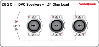

Wednesday, December 03, 2008 - 01:38 GMT ok here's the deal. there are 3 dual 4ohm subs. so i was thinking of wiring it like this. sub 1......series = 8ohms sub 2.....parallel = 2ohms sub 3......series = 8ohms then wire all the + together and - together and it will result in 1.333 ohms.

Wednesday, December 03, 2008 - 01:53 GMT so it will look something like this.

Wednesday, December 03, 2008 - 01:59 GMT You can get 2.667ohm or 0.667ohm out of 3 DVC4's. I would not run it the way you have it...the center sub would see more power than the other 2.

Wednesday, December 03, 2008 - 02:13 GMT alright gotcha. looks like i am gonna have to go with 2.667ohms. damn that means i am barely gonna get 900wrms out of my amp.

Wednesday, December 03, 2008 - 02:15 GMT the twosubs wired to two ohm should see 4 times as much power unless im mistaken

Wednesday, December 03, 2008 - 02:17 GMT if you think about it though, its the final ohm load to the amp is what matters isn't it?

Wednesday, December 03, 2008 - 02:21 GMT x2 what canaan said... It's not good to have the one sub getting more power than the other 2

Wednesday, December 03, 2008 - 02:30 GMT chad the center sub will still see more power because it has a lower resistance.

Wednesday, December 03, 2008 - 16:31 GMT yeah rovin they only come in d4. M, the subs are the new rd sq subs. i hooked them up like canaan said and got 2.6ohms. since these subs are efficient from 300wrms each, it sounds awesome. i am roughly seeing like 700-800wrms out of my dls A6 amp but its enough. besides anyone that owns a dls amp will tell you they get fairly hot. now they run alot cooler.
