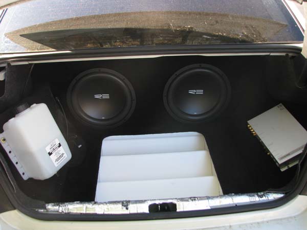

coming along.. still some fitting to do and minor tweaks here and there
then the horrible part of wiring everything up :-(

Kevin, curious shouldn't the subs be facing into the cabin? Looks to be a reverse seal job I see the trunk flexing now.. Polo.

Not trying to be a burn but I have plenty of experience with a sealed trunk, I was just asking a question to kill the curiosity. Polo..

its not completely sealed.. theres a gap at the very top of the beauty panel
thinking about porting the rear deck as well

Porting the rear deck would be a good idea I think.

ok im new to custom trunk setups and stuff what is that bottle to the left?
Username: Frkkevin
Team DLSSuperNatural...
Post Number: 5867
its not a bottle, its a tank
and that is for meth injection

But porting the back deck if it isn't extremely large it would effectively make it a "band Pass" and mess with any and all tuning. The open trunk area would be secondary chamber. Polo..
Diamond Member
Post Number: 22659
the bass will get through polo. the bass will resonate off the car and you will hear it.

No it will resonate the car and change the tune, there is a difference. You could hope that the box would resonate more than the car and have the back of the box radiate but looking at his tripple baffle I would say that is less likely. I would say he is going for an SQ setup but that would be hard to do with the car resonating, backhalf anyways. I see a lot of trunk compression happening, waste of power and effort. I am in no way knocking anything he has done Kevin does great work just don't want him to go through all that work just to have to pull it out. If I was him I would try the box one way then the other using old rags and towels to seal it up and see before it is all mounted in. It took me more R&D work to get mine like it is than anything. You would be surprised in the output gain when you effectively separate the front/back wave. Polo.. :-)
PS- I'll leave ya alone now lOl.

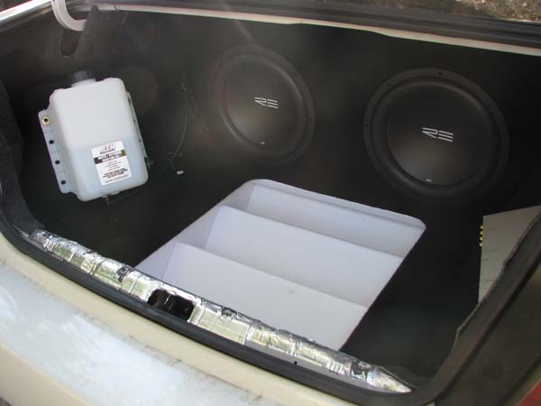

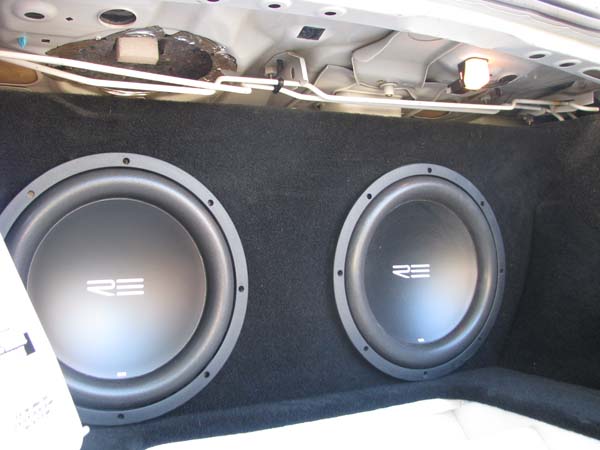

its only a double baffle.. and this is SQ.. hence the sealed box :P
until my other XXX comes in i put the two SEs in for test fitting everything..
still gotta mount the amps and hook it all up..
heres pics polo to show it not being all the way sealed off..
