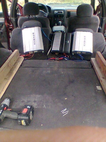

I didn't take to many pics.But I do have a few for the 1st day of this sub enclosure build and sub swap..

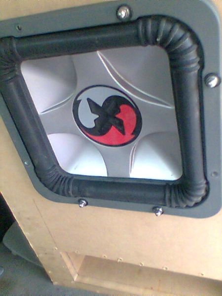

Taking out both Solo X 12's..
out with the old

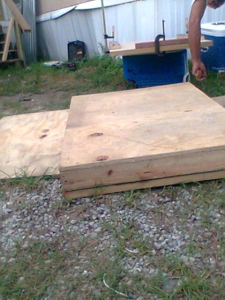

strarting to frame out the artificial floor
(box needed to be raised enough to clear fender wells"
finished floor (without carpet) outside of the vehicle.
Starting on the Baffle
early into the box build
some random pics
I do have the art. floor in vehicle.
have 2 more cuts left.
Port is complete
Need to still install the all-thread, nuts, and washers. 45's for the corners and cut mounting holes for the subs.
Probably wont be carpeted anytime this week.
Will get pics of these HUGE subs on next round!
Just thought I would share.
subs: 2- 18" RD Alpha's V.2 D2
enclosure: 11.75^3 ft., common chamber, 80^2 in. port., tuned to 35 Hz.

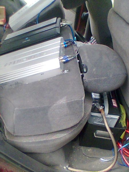

Mark we have the same car :-)
Was it a pain in the as$ to mount the amps to the back seat? Never got around to doing mine.
Username: Hittin1
Lake Charles, La. United States
Post Number: 1114
it was untill i got the right tools... kicked my azz at first... they have been there a while.

"the right tools"
elaborate?

cordless drill wouldn't work for me... needed an air drill.. one of the lil ones to really put some pressure on the bit(s).. broke more than one, lol... sh!t(back of seat) must be made of diamonds.

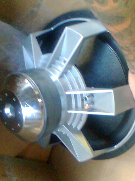

A few pics of the sub:

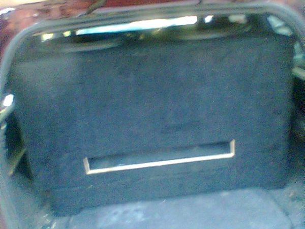

Carpeting done.. Just showing the Double baffle and the all thread.
Everything installed... used 8 Ga. wire for the speakers
Vid coming soon.. likely tomorrow. when I can use my good camera. The Canon SD750 handles the bass with ease. By far the best Bass video camera I have ever seen.

That box looks like it almost won't come out.

you would not belive how tight of a fit it is... I decided to double baffle the bottom as well(3/4"&1/2") and almost couldn't get it in there,lol

It wont budge,lol. It is fu(kin' heavy as h3ll.
