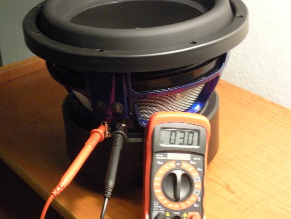

First, the box i had built for my 10" revo sucks. Im getting port noise and its like a one note wonder. Im thinking of running it sealed. What do you recommend?
Second, Is it normal for the Revos coils to read 2.9ohm? I had it bridged on a treo 250.2 which should do about 1200w at 4ohms and it just wasnt right so i looked and it read 5.8ohm.

Yea, exige has been very helpfull. He is gonna take care of it. Here is a picture of the revo.

Touch the DMM leads together and see what ohm that reads. Then subtract it from the 3.0ohms.

It read .09 ........ does that just mean its off or somethin?
Username: Tatonka
-[Team Audible Insanity]-
Post Number: 2012
Then your coils are 2 ohms.
Your DMM leads have .9ohms of resistance. So you got to subtract that from your gross resistance to get the sub resistance.

oh ok, thanks. I learned something new today. Now I just gotta figure out the box problem.
