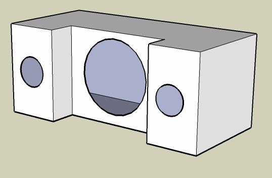

nick something like this?
Username: Tatonka
-[Team Audible Insanity]-
Post Number: 1865
Yeah chad, something to that effect. Would look beastly :-)
Diamond Member
Post Number: 21485
alright thanks nick.
i was also thinking of cutting a 8 inch pvc pipe like 2 inches. then use that as spacers. it could look good too.

Chad- what did you use to draw that up? Some program or are you just a god of ms paint?
Username: Tatonka
Post Number: 1868
Google Sketchup.
