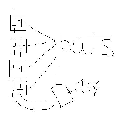

nevermind u prob need more than one battery to keep is going for 4-5 hours. maybe like four batterys wired together.
like this
sorry about the sloppyness. one batt will not run that for four hours. if you wire the batts like in the picture you'll have 12 volts but u can run longer. this is parallel if u wire in a series u'll have 48 volts and blow the sh!t out of ur amps and stuff.
