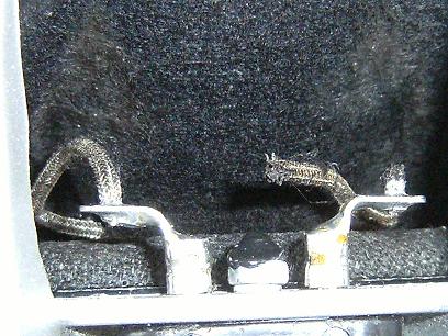

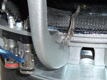

K well i just took my sub out of my box. And the string things that connected to both negative's are burnt and broken not exactly sure how to explain this so i'll take some pics. but if that is the problem how do i fix it?

Ah ha, the infamous Fi Q broken tinsel leads. This is a persistent problem with the old Fi's before they starting using woven tinsels, this is why I told people not to buy them before.
Contact Scott see if he will fix it.

Ok, Thanks everyone for the help. Also why did the tinsel leads break? Anything i can do to stop it from doing that again?
A pic is worth 1000 posts!!
Post Number: 16048
Over excursion coupled with tight leads?
Username: Nd4spd18
Northwest PA
Post Number: 7386
Over excursion would do it, but in order for that to happen you have to be feeding the subs A LOT more power than they are rated for (and the coils would probably overheat first anyways)
Or not have the SSF set right on the amp. SSF should be slightly below the tuning of the box, without it the sub will play below tuning, where there is no resistance from the box.
If your SSF is right you probably didn't do anything wrong, this is just a design flaw of those subs.
