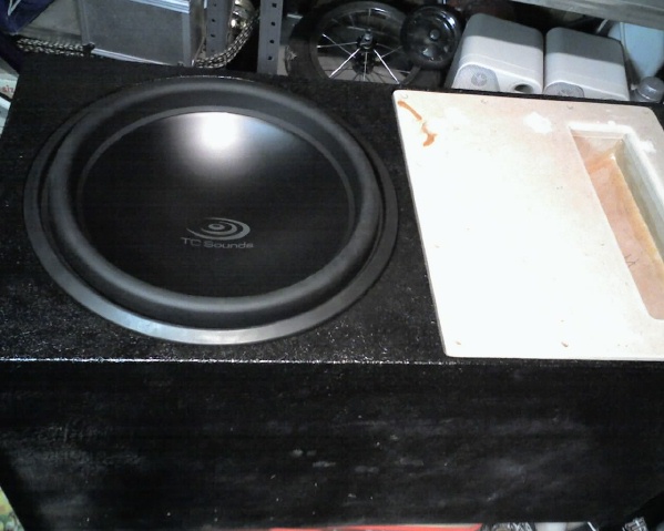

If you aim it into the cabin, you had better get the whole front exposed into the cabin and also you will need to seal off the trunk or you will have cencellation issues. I have a 2001 grand prix and my box face is into the cabin while the trunk behind it is sealed. Found this to be the loudest by far, gain was huge but it must be totally sealed. This was the cheap box I used as a former, served its purpose as a test dummy.
Here is what it looks like after I cut it out, waiting for the temps to rise so I can do some glassing...Polo.
New box will slide right in no problemo just takes a little imagination...

What's the purpose of the window?
Is that the LMS?

No that's the 5200. And the plexi window is for vanity... Polo loves that sort of thing.

lOl Rightttt .... That isn't a plexi window, the port wasn't in See VVV.I will finish the ports after the box is in. Polo.
PS- Paul that is a 5200, louder than a LMS...
