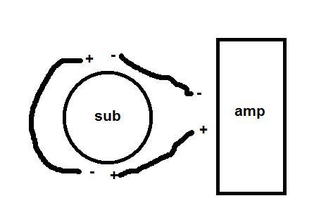

also like reece said, it could be wired wrong. the sub is dual 1.5ohm. if they wired it parallel then it is going below ohm on that amp. it has to be wired in series.

Los Angeles, CA USA
Post Number: 19857
is it connected like this?
