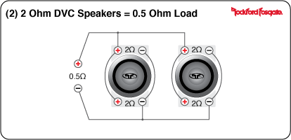

i'm going to take pauls advice here and say he's on the right track. i'm going to say your wired to .5 not 1 and as you crank it up the amp is strong enough to come alive then just die for protection of the amp. also the way you jump out and say thier wayyyyyyyyyy louder and you haven't even cranked them plus turning gains down makes a whooooollle lot of sense that your wired down to a low load. and 2 x 2 is not 4 it's typicaly 4x4 so i can bet this is your whole problem, try wiring back to a safe ohm load and see what happens, i bet your amp runs fine.

no its in my 90 prelude, i grounded it on one of the bolts on the side of my trunk, i wired it back to 4 ohm and it pumps pretty loud, so since it says 2ohmx2 this doesnt necessarily mean its 4 ohm? can anybody check out forsure what kind of wiring i have to do? id rather do 1 ohm or 2 ohm instead of 4 ohm, let me know thanks for the help,

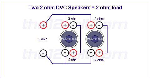

You have a dual 2 ohm subs. Wire them like option #2 in the chart paul posted, into 2 ohms.

lol need to change voice coil configuraction

dude there's your problem. you are going below ohms. 2ohm x 2 is dual 2ohms.

This is how you wire your subs...
If you thought you had 4 ohm dvc and you have them wired to 4 ohm.. then since they are 2 ohm dvc they are probably wired this way already... due to the subs 2 ohm voice coiles you are only gonna be running half the power that you need for those subs.. Did you buy them new... if so can you exchange them for 4 ohm voice coils? That would be ideal..
