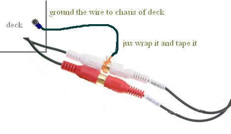

anyways charlie, ground the rca cable to the chasis of your head unit. you can wrap a cable around one of the rca cable and the other end you can ground it to the chasis on the headunit. on the back of your hu, there is a little screw. just undo that and wrap the other end of the cable to that screw and screw it back on.

Just ground your rca's like chad said i had the same problem.....

I just did grd the hu and it took all noise away and then i took the grd's off and the noise came back. But i think there's more to it than that because it wasent playing anything at all I could barely feel the sub bumping in the back but i got to give up today its time for work so Im gonna try to work on it 2morrow but i think thats gona be impossible unless I wake up super early so looks like sunday night will be the next time I can work on it

A few people have fixed this issue by grounding the RCA jacks on the back of the pioneer head unit. Mostly just taking a small wire and conntecting it to the head unit chassis, then wrapping it around the RCA jacks. Very strange solution, but seems to work.

ya rob i did do that and it worked for the sub it stopped the horn noise from the comp speaker also but theres still something wrong with the comps i think its the amp though
