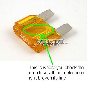

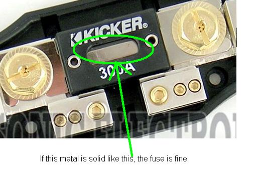

open the top and see if any components look burnt/ disconnected.
Look at the fuse if the metal isn't broke/burnt its fine.

That is the major sign of a blown amp. Its possible to not tell by looking so i wouldn't open the amp, like chad said.

check the fuse the way I said and if its not blown your fine and even if it is your probably still fine...but pop a new fuse of the same rating in if its blown

Post Number: 540
somewhere on the fuse you should see an opening in the middle with metal going acrossed it. If it isn't broken (the metal is solid with no breaks) then it is fine. You shouldn't have to take it out to see this. It should be pretty clear.

yes that is correct...
here is where you check your inline fuse

Pull the 3 ( or 4 ) fuses out of the amp and check them as follows.

i have no blown fuses as far as i can see no burnt marks no breaks in the metal either??? ahhh... so ur saying i touch the ground on the amp to the negative battery terminal??? sounds dangerous? should i do this before or after the power wire is inserted into the amp?

its very good that the fuses arent blown...you checked the one under the hood also right
