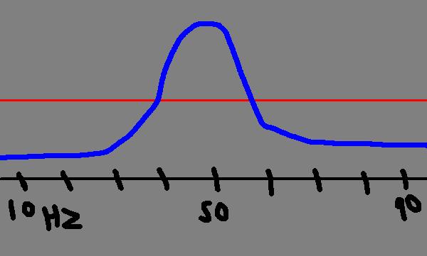

You don't seem to understand how bass boost works. You CAN NOT set gains with it on. It increases one frequency, and decreases other frequencies. See the sketch i'm uploading to try and explain it. You will get an inaccurate reading.
