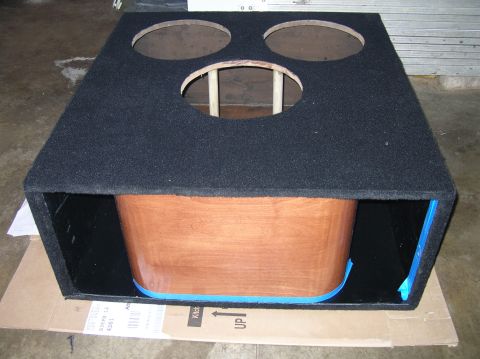

Monday, January 21, 2008 - 03:48 GMT thank you 3 Audioque HD315 receiving about 1200 watts rms each

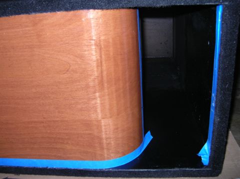

Monday, January 21, 2008 - 04:15 GMT Looks very nice. Doubled baffle may have been better though. I have a few questions if you dont mind: What are the box specs? What vehicle? What meter? Ever had that vehicle metered w/ another system? If so, how loud was it...what freq did it peak at?

Monday, January 21, 2008 - 04:18 GMT what kind of ride is that going into? looks awesome!!! is that oak?

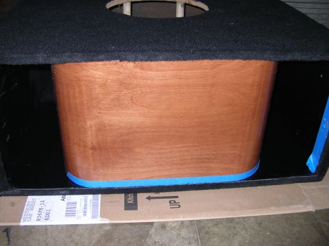

Monday, January 21, 2008 - 04:19 GMT The box is 39" wide x 40" deep x 15.5" tall (inside dimensions). Both of the ports are 6.5" wide x 14" deep x 15.5" tall. The box is tuned to 40 hz. The vehicle is a 2007 Toyota Matrix And the meter is a Epic-160

Monday, January 21, 2008 - 04:28 GMT thanks Canaan and Mark scafetta! The wood is MDF with a oak veneer on it and stained cherry with about a 1/16"-1/8" of varnish to give it a nice sheen

Monday, January 21, 2008 - 04:35 GMT The box takes up 13.5 cu ft of the 94 cu ft in the vehicle

Monday, January 21, 2008 - 14:42 GMT what is that about 4 cf net per sub.....if so thats a little large and will hurt the spl score some...im figuring a 148 db probably with that port and sub arrangement with a slight possibility of a 149 db sealed up at the dash all assuming you have sufficient electrical like a large ho alternator and a battery

Monday, January 21, 2008 - 14:59 GMT He has a small cabin though so I think he'll be right around 150.

Monday, January 21, 2008 - 18:14 GMT thanks guys. Sean the box is built by the specs for the HD3 series of subs.
