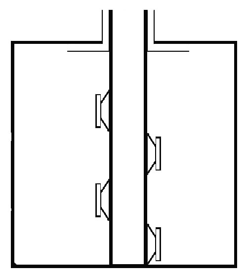

At the old shop I was with we were doing a truck for SEMA in Las Vegas, we used 4 12" Orion subs, We tested it a bunch of different ways, The best we found for that situation was kind of like this picture, offset you subs never point them right at each other. That actually lost bass, same concept as noise cancellation.Upload

MeSoDumm, what if I only use a pair of 12"s, will it have the same effect?

Yes, just make sure you use correct specs!! it will sound good!

So, judging by your diagram MeSoDumm, you want the gaskets to "overlap" or would you want the gaskets to basically be right up next to one another, if taken out of the box and put closer together?

Chad's got good idea!! Yes the gasket would overlap what ever els you put there, accordions are nice but still need just a bit more. The way we started doing them was after metat was cut we grind so not so sharp, cut small tube in half run over edge, then use heavy duty pipe insulation then start wrapping with innertube it doesn't just stop outside nice, weather but also the body does twist just a little espeacialy in 4x4. smaller area cut better off you are,

MeSoDumm, I meant the gasket ring on the speaker, is that what you mean? or are you talking about the sealing aspect of the blowthru?

Lost me for a few! gasket ring for speaker? don;t even know how that got brought in to this! or would be anything involved! sorry! yes! sealing of blowthru! Box looks good any new picks???

lemme re-phrase, how you have the speakers mounted in the diagram, the speakers are "off-set"
my question is, hypothetically, if there were only 2 instead of 4, and you removed both speakers from their baffle and moved them toward eachother until they touched, would the rubber gasket(or top of basket) on the speakers touch or would they butt up, side to side?
