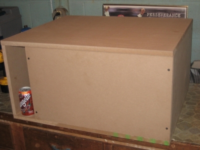

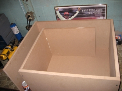

So earlier this morning, I was finally able to manage my enclosure into my trunk, and wire everything into place. Started up my Grand Prix and everything is working fine. The ASA has a pretty sweet blue LED light on it that lights up my whole trunk, the SE's really pound, and the HO Alt I got from DB is working perfect.
Although when listening to the SE's, I found a spot where air is escaping from the enclosure, so i'll have to seal that up when I get some more free time.
I do have one question about my SE's though. Ive noticed that the SE's are really good at picking up really low notes, but they arn't so good at picking up any other notes!
Could this be because of the length of my port? Or even how I have my amp tuned?

post specs of the box joe. Thanks man for all your questions and posts about your setup, i'm really considering an upgrade to powerbass... OMG that benchtest showed i wasn't wrong lol.

Where is your LPF set to?

Right now, my LPF is set all the way down. I was tuning my amp, but no matter where I had the LPF and Sub Sonic, the SE's still seemed the same way. That is why I think it might have something to do with the enclosure.
bench test results on my ASA1500.1D amp:
1434 @1ohm
728 @2ohm
371 @4ohm
Enclosure Specs:
2.5 Cu Ft
Tuned around 34/35 Hz
