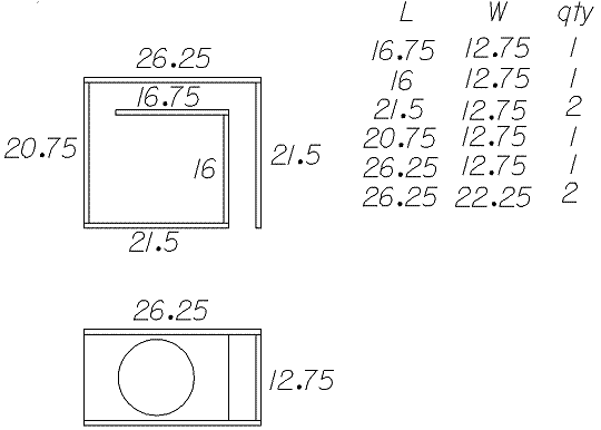

im jsut curious as to how big i should make it...i was thinking around 2.3-2.8...its a 12" and im looking for spl mostly...any help would be greatly appreciated

DD 9515f, 148.2 db Mov...
Post Number: 4935
Registered: Apr-06
2 cubes
60 sq inches of port
tuned to 42hz
Username: Mateo
Post Number: 171
alright thanks...i was thinking 2.5 but very open to suggestions...i think i may tune it a little lower to about 32~33 because that is what my G5s are tuned to now and i love it...but you think 2 cubes would be alright to hit some lows and all? i want as much spl as i can get from it...

Username: Drivingreckless
Post Number: 4943
Registered: Apr-06
CAM, well i figured he wanted SPL to the max lol...
but if its daily just do this mateo
2.25 tuned to 35 hz and 60 sq inches of port...
2.25 after displacement of port and driver. makes sure to take that into effect.

is 60 not to much...isnt it like 14-15 sq inches per cuft? or am i wrong?

most people say its too much...then again most have built as many boxes as i have.
trust me its enough if you want i can post a design for you?
Post Number: 4960
Registered: Apr-06
2.25 cubes 34 hz 50 sq inches

sweet thats awesome man...i appreciate that...i trust you i was just wondering...is there anyway to make it a bit taller so that ? if not its still fine ill use it...its just a little pet peeve of mine :-) thanks again

oops it left a part out..what i meant was is there a way to make it a bit taller so it doesnt look like the sub is stuffed in there....if not its cool...

you have enough room =P

i love it though...i love big ports like that

ok...ill have to stand it up though so it fits in the back of the cab haha...thanks you!
