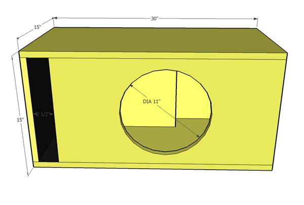

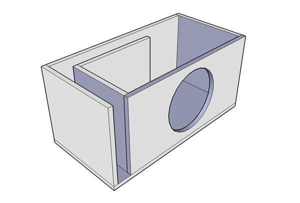

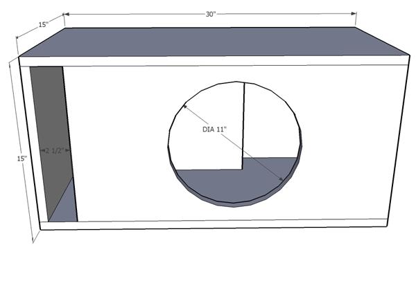

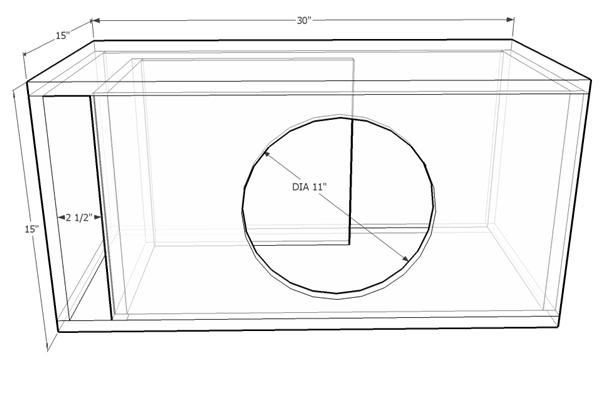

you looking for ported or sealed?
Username: Jesse59672
OKLAHOMA
Post Number: 801
or bigger pics:
http://aycu30.webshots.com/image/35869/2003830194772910954_rs.jpg
http://aycu25.webshots.com/image/35064/2003813522606247666_rs.jpg
http://aycu23.webshots.com/image/38222/2003806364249195262_rs.jpg
http://aycu40.webshots.com/image/35039/2003861978582120919_rs.jpg
http://subwoofertools.com/forum/ported-box.asp?Ew=30&Eh=15&Dia=6&Xmax=18.1&Vd=.071&NumW=1&Vb=2.2&Fb=35&Qts=&Vas=&Fs=&CE=0
OKLAHOMA
Post Number: 805
30 x 15 x 15
2.2 net cubic feet, tuned @ 35hz
Username: Comerz
Post Number: 89
Registered: Nov-07
o nice thx jessie, yea im lookin for ported. IS that how big id make it for an alpine?
OKLAHOMA
Post Number: 809
it's just your preference, unless your building exactly to alpines recommendations. i think 2.2 cubes @ 35 hz would sound good, but in the end it's just up to you and what kind of music you listen to.
