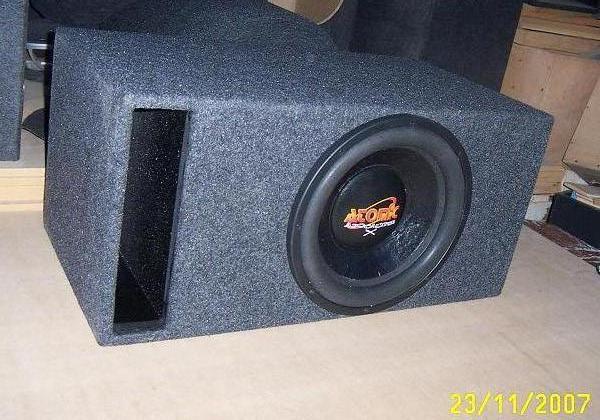

here is a recent pic of a 15" Atomic APX box i did
