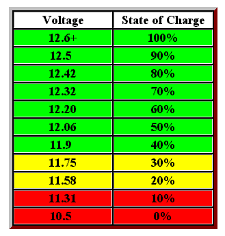

This is a good chart to show you what a battery's state is per voltage reading. These are at rest voltages but you get the idea.....long term exposure to these low voltages will kill your batts....
