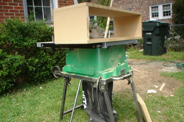

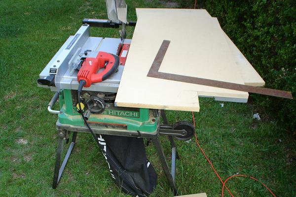

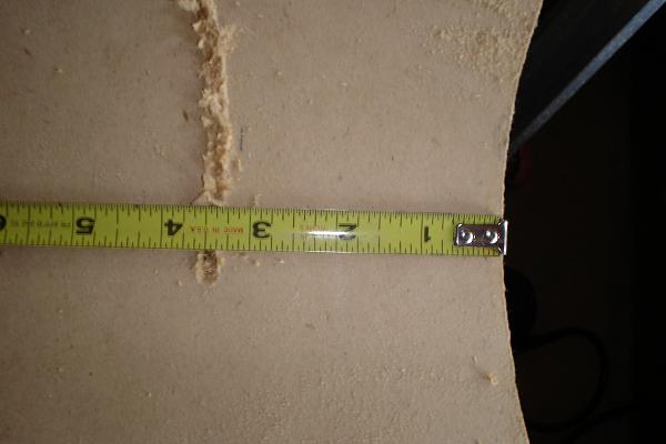

So there's my cheap table saw. It works great for what it is. That angle was cut free-hand with a jigsaw- even still it's damn near perfect

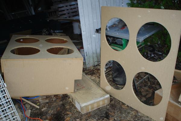

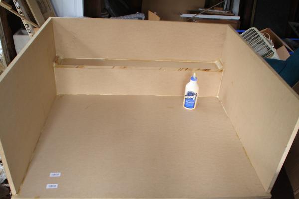

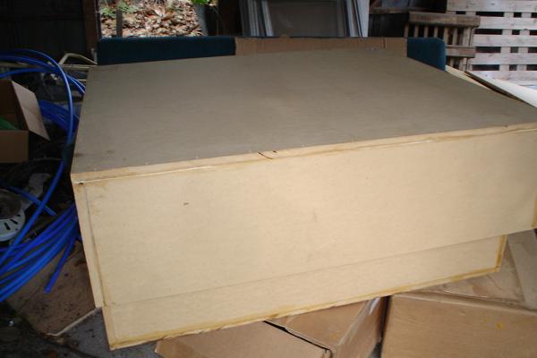

I started putting the sides and back together.

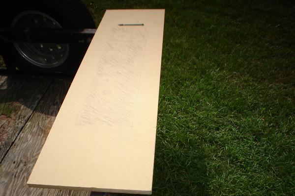

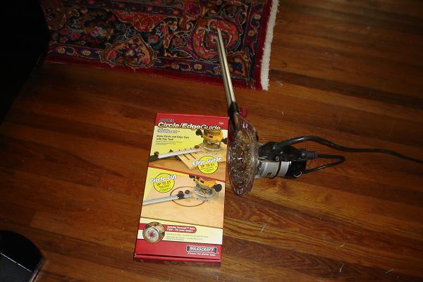

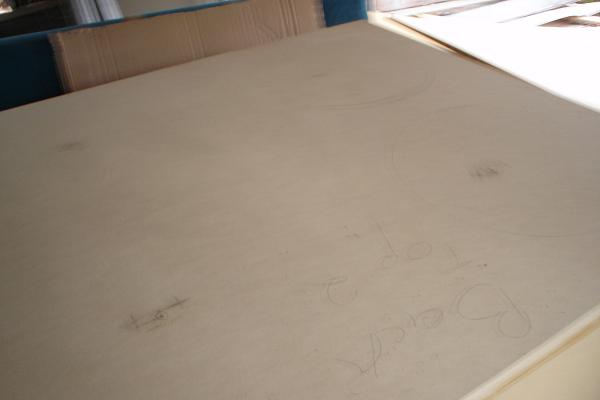

Pic of the back and the circle cutting thing I bought. It looks fancy, and it'll cut anywhere from 8" circles up to 50+ inch.
I'm making an interchangable port, so I had to make it this way. I tried using a that circle thing, but I broke the bit by rushing it. I'll just go exchange it tomarrow and try again (that was just a scrap piece of wood).

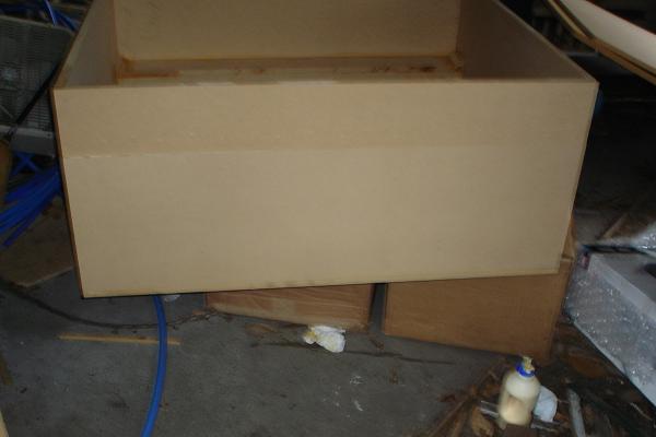

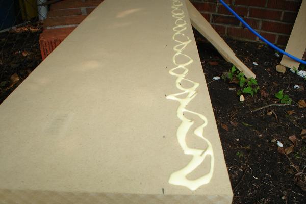

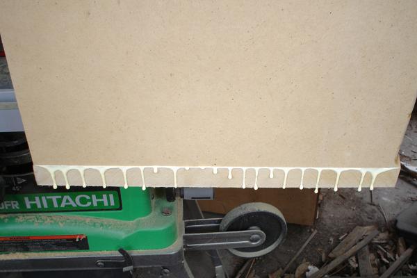

Some corner pieces that will be fiberglassed in place. I put a bottle of titebond II in there to show how big it really is. The final port will be 30"x8".
That little piece of wood will be where I'll countersink the threaded rod that will be bracing it. I really hate the look of threaded rod, so this will make it so you don't have to see it.

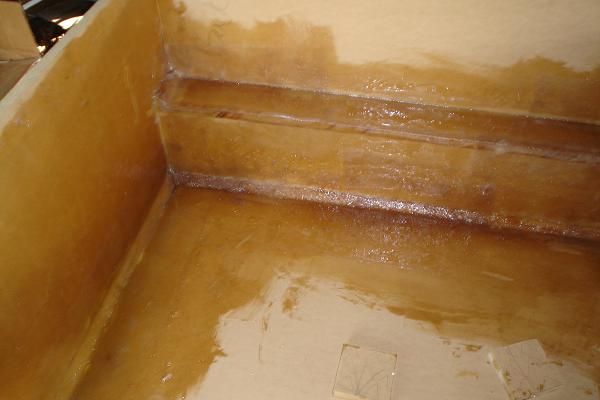

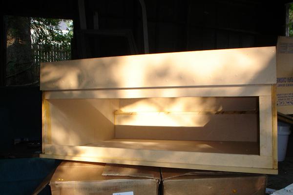

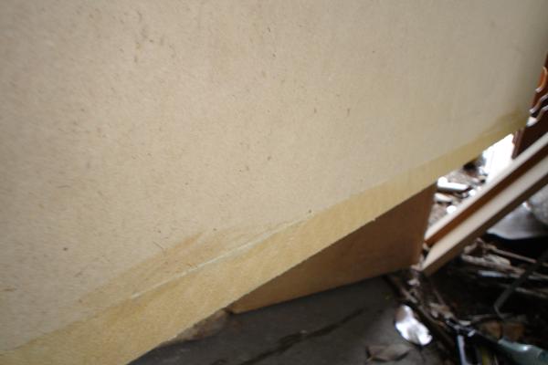

Okay, 2 layers of mat and one of cloth later, I ran out. I got the bottom corners all covered good, but I'll be going to lowes today anyway. I didn't realize how much I was going to need.
Crappy 4.1 meg camera, and the lights hitting it wierd, but theres a bit of progress.

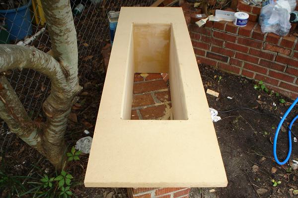

Mock up of the port. Pieces line up nice, they're just not fastened together till I roundover the port.
I cant work on it anymore for a while - have to do real work.

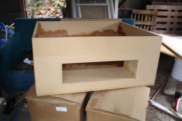

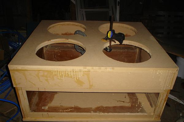

Okay, a bit of port work today. Got the port together. It's raining, so I'll have to wait for more glass, but it's coming close.
Glueing the pieces together before a few finish nails..
3/4 round over bit on the router
Sides of the port assembled
Used a jigsaw to cut out the opening. Unfortunately I was about 1/16th of an inch off from straight in a few places, so I had to trim it up and sand it some. very close to perfect, but not quite. Still good imo.
Putting the face and the port together
Just another angle. Then I routed the edge off again with the 3/4 bit.
Dry fit before putting it in. VERY snug.
Here's how the finished product will look minus the two layers of mdf on top and some bracing.
I don't know how well this pic shows it, but that's completely tight. I have to tap it in. Of course there's going to be a gasket behind there when I finish it up, I'm just debating painting the port or carpeting it to match (painting the inside black no matter what, just the outside.)

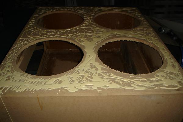

Ahh, just got the hoe back a few hours ago. I'll be yanking out the other subs and amps, then getting some pics everything together. ;)
I didn't have time to do the holes and it was too humid for 'glass, but tomarrow I'll finish that. Then carpet.
Sunday a few people are coming over to help get it in- colby, you're more than welcome too.

Testing out that hole thing. It worked pretty good with the new upspiral bit.
I put the bottom layer on, I didn't want to put the top on till I cut the holes and was able to clamp the center tomarrow.

...where did you get that circle cutter or where can i get one like it and how much are they???

Thanks! Circle thing is with the routers at lowes. ~40-50 bucks.
Paul, thanks.
Got one hole cut. It's 1/16th over 16.75 inches, but that won't matter a bit. I really am enjoying using this thing now. I don't have time to post pics 'cause I'm in a wedding about an hour and 25 minutes from now, I'll just have to finish up tomarrow. :-( Pics tonight though.

Okay, got in an hour or so this evening after the wedding. Also got the washer and dryer going :-)
Those subs are going to be pretty close.
Marked the holes. Cut one. They're 1/16th of an inch bigger than 16.75, but it's fine.
Username: Tejcurrent
Post Number: 327
Registered: Apr-07
OK, got the holes cut.
I had the two layers seperate because it made it better to glue them together and clamp.
Glued, screwed, nailed, and clamped for the night.
I'm putting a layer of glass on the port- I just sat it there for now. Things are REALLY messy >:-(
Oh, and if anyone was paying attention, that's a full sized couch I've got teh box sitting on at the back (see the armrests on the sides?).

Username: M0nkeyman692
Post Number: 312
good idea on the double layer mdf. nothing worse than a box flexing its self to death. breaking seals makes it a big waste of time
Post Number: 332
Registered: Apr-07
I'll be putting a 3rd layer on top as decoration, but it'll also help a bit too.

doubling up seems almost needed to make this box practical though
Username: Alex_smith
Registered: Sep-07
yeah i figured you would use them for now. id be happy to go there and help you out the only problem like colby said is us getting there. we'll see what kevins work schedule is for this week and unless something comes up we'll come over there with him one day.. but for now keep the pics coming and keep up the good work.
Post Number: 314
yea definitly. im thinkin about doubling up on my box for a single 18"Q. i know its probably not necessary but it cant hurt
Post Number: 334
Registered: Apr-07
whats a waste of time and money naledge?
Yeah, once you cut those holes in there that baffle just loses a lot of rigidity, but that's where the fiberglass and threaded rod will come in.
Post Number: 318
^^the waste of time and money would be not doubling up your box for support

Yeah, I'd add more layers if space permited, but it sadly doesn't. the 3rd layer of baffle will be a beveled sheet to finish things off and hold amps-pics to come.

Some light hand sanding to get nice smooth edges, get off the little rough spots the router left (I had to do multiple passes because it's only a 1" bit :-( )
Getting ready for the 1/2" threaded rod. You'll see it sticking out of the top before I put the trim plate on, but then it will be covered.
Painted the port black, getting ready to carpet that this afternoon.
I have to go to a memorial for my wifes grandfather who died 1 year ago today. Then work on some plumbing around the house.
Progress tomarrow if not tonight- I will be finishing the fiberglass so I can have it dry for tomarrow.
