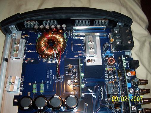

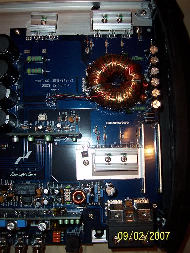

OK, since its not working, I opened it up and took some pics, bad part is that all the soldering is on the bottom and I don't know how to take it apart any farther than I did...If anyone sees anything amiss, please tell me

btw, its even pretty inside....lol

its getting power, but won't put out anything...the light on it comes on for a second, it sends one quick shot of power to the subs (I hear a quick thump, and I used a meter too) then the light goes to blinking and no power coming out.

relatively plain looking imo.

Try "bench" testing it. Jump the power to remote, and hook up to the battery with short whips. No Sub. Does it stay on?

btw, if you want to take it apart further, you need to remove the screws that hold the fets down to the heatsink, then the board should slide out. I dont advise it, cause there is temp grease and pads under the fets to help transfer heat. and can be a pain to reassemble.

If there are no burns on the board, amps can usually be fixed.

basic internals

a wire came lose and may have shorted agianst the case, I think its an easy fix. Just have to find a place to send it to
