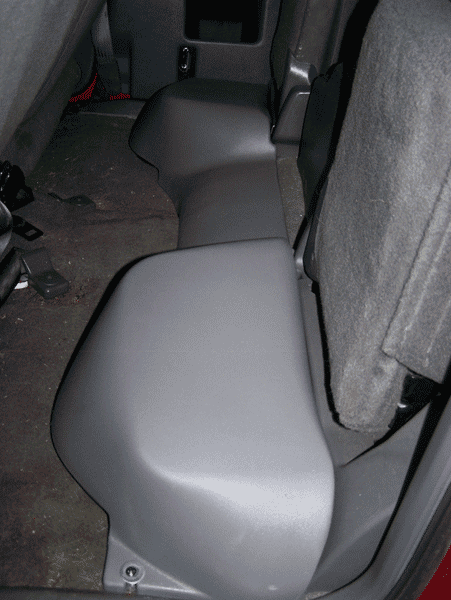

Hi guys,
I got a MTX Thunerform unit in my Ford Ranger with 2 10" Thunder4500 subs powered by an Infinity 300w mono subwoofer amp.
I've had them for about 2 weeks or so and I just started noticing something unusual. When music is playing at low-mid volume (low enough so conversation can be heard over the music), I've been noticing a strange thumping sound coming from my subs.
The noise is similar to the sound they make when i turn the truck off or i set the volume to 0 (which i attributed to be the subs shutting off). But now, it's making this sound while music is playing. It happens randomly but it's it's becoming more and more frequent. I noticed it would happen when i hit little bumps in the road, made a sharp turn, or hit the brakes. sometimes it would also happen when i'm just sitting there. So now i'm starting to think something got knocked loose and is hitting one of the speakers but i can't be certain and i don't even know how that would have happened.
any ideas as to what my problem might be? i could use all the help i can get. I've only had these subs for 2 weeks and they are MTX as i've said. I don't think i could have blown them out already eh?
Thanks for the help
--Sean
Upload <--my subs
