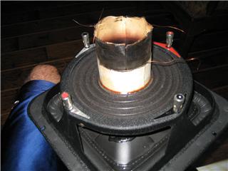

Blown, install place wired this sub to my amp at .5 ohms, brutus hifonics 1606d , knocked off rear view mirror b4 it died, played for 2 hours b4 it fried, I untangeled all of the coil that was down in the magnet, and im gonna buy a spair andd wire it right. it was a brave sub and sounded amazing............also there is a pic of my L7s tooUpload

here are more, the surround cracked but u can hardly see it

MASSIVE CLIPPING

was the gain at least set correctly????
Sounds like you clipped the fock out of that amp!

ya thatss what happened, told ya i was gonna take pics, ya we tuned it at real low levels, real low low sound ...........sad huh
at least i will get a a new 2007 spairUpload

I've seen those laugh at 3000w daily. I would not be suprised if that amp is not toasted.

^^ Agree. I remember when you got the sub and everyone told you to get more power. What did you set your SSF to, and what did you tune your port to?
I think that thing was clipped soooo bad it's amazing you couldn't hear it. I'm not bashing you, but I'm saying you aren't doing that sub justice, and the fact that you burned it up like that shows the amp wasn't set right- as it sure wasn't overpowered.

Maybe it was a 12" then , I don't make useless information up it was a solo X' and it was big with no magnet almost like the pic above but with more wound copper wires still intact.
