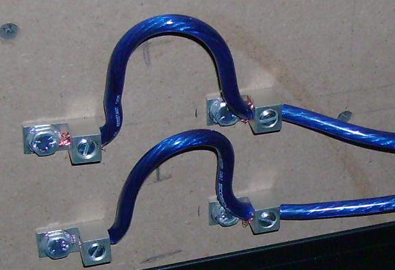

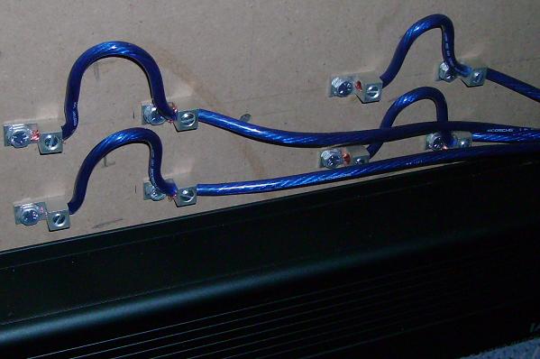

Monday, August 27, 2007 - 03:27 GMT I have alil terminal design you might like I'll get some pics of my new box and put em up in a sec.

Monday, August 27, 2007 - 03:50 GMT You can get those terminals at Lowes...use use a bolt to mount them. The is 8ga wire in them. I wired each VC to its own terminals...that way I can change the wiring from outside the box.
Username: Adam_s Post Number: 1871 Registered: Aug-04
Monday, August 27, 2007 - 03:54 GMT Nice. I do like.

Monday, August 27, 2007 - 05:04 GMT That design reminds me of the box i made in the blazer for the 2 9515's

Monday, August 27, 2007 - 05:20 GMT thats tight seems like a really good idea but would you really use it? i don't exactly plan on changing the wiring for my sub ever

Monday, August 27, 2007 - 05:35 GMT You might not use it, but i am going to. I'm gettin another ia20.1 sooner or later...when i do, i'll strap the amps at 1.5ohm daily and burp at 0.375ohm.

Monday, August 27, 2007 - 05:44 GMT "thats tight seems like a really good idea but would you really use it? i don't exactly plan on changing the wiring for my sub ever" i do. i run my subwoofers at 4 ohm and 1 ohm for a slightly nicer sound. it balances everything out abit more like that... it literally takes me less than 1 minute to change it from 1 to 4 ohm. and canaan, do you know the specific name for that type of terminals. ive tried to find them in brass. i think they would look sweet brass with brass allen head set screws...
