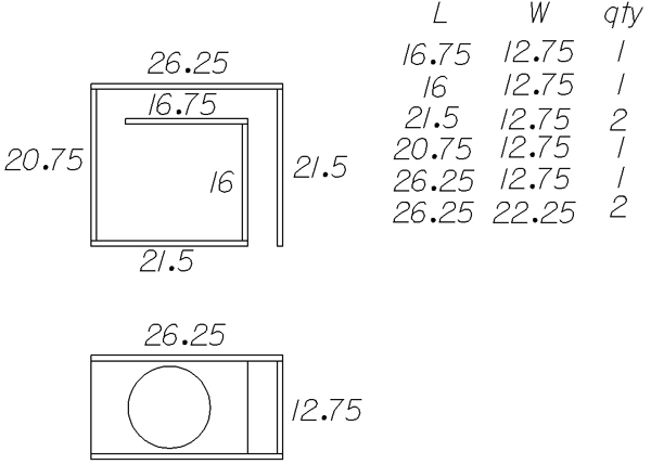

Wednesday, August 22, 2007 - 20:28 GMT i want to build a ported box for my type r... ive heard 1.75-2.0 cuft is optimum and tuned 32-35 hz... does anyone have plans or blueprints for this type of box slot or tube ported

Wednesday, August 22, 2007 - 21:31 GMT 15.5 high 12.25 deep 19.5 wide with four two inch pvc ports 14.5 inches long for a 34 hz port tune....port it on the side
Username: Insearchofbass Post Number: 6220 Registered: Jun-04
Wednesday, August 22, 2007 - 21:35 GMT those are internal measurements and should put you at 1.85 cubic feet after the sub and ports are in

Thursday, August 23, 2007 - 04:25 GMT that's my design from driving wreckless it pounds like hell.

Thursday, August 23, 2007 - 04:31 GMT sorry i left out, thats 2.25 cubic ft at 32 hz.
Username: Insearchofbass Post Number: 6230 Registered: Jun-04
Thursday, August 23, 2007 - 17:25 GMT there you go I stayed away from that design partialy due to easier construction but a slot port is the best way to go
