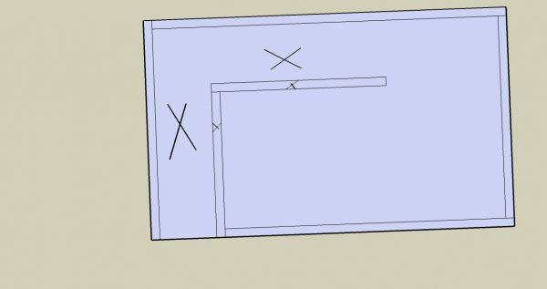

________________________
____________________outlet of port
I don't know if this will look right, but if it does, above would be the side view of the slotted port, and below the short line would be the inside of the enclosure, and the long line is the exterior of the box and the left end is the corner of the box.
The volume that the port takes up in this diagram, adding the .75 for wood, do I add that volume to the total cu ft of the box or do I make the box and add the port walls inside of it and disregard the port volume? I don't think I was clear earlier, maybe even now?!?!?!?

Username: Imnothereimjustvisiting
Post Number: 85
Registered: Aug-07
u calculate displacement for the pieces marked w/ an xUpload
Username: Press1
Yuba City, CA USA
Post Number: 83
Registered: Nov-04
Nice!
So, just to be clear a 4.5 cu ft box would be all the open area inside the box, including the port.
Username: Kravenblood
Ohio Hmmm
Post Number: 284
Registered: Aug-05
if your subs need a 4.5 cubes than no it excludes the area of the port
Ohio Hmmm
Post Number: 285
Registered: Aug-05
example everywhere but the port = 4.5 cubes in the pic and the port = 1 cube youll have to build a 5.5 cubed box... so that pic with the port is 5.5 cubes
