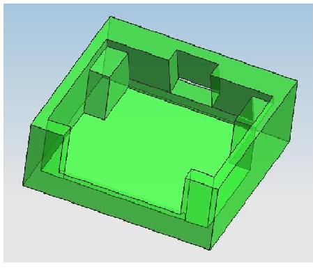

I have a parasolid model of my trunk in Unigraphics, if you want that. Also, the dimensions are: height - 14in, width - 36in, length - can be up to 45in.

Just got home, the dimensional height is 17.5", but I would say 17" is best.
Thanks Nick.
Any other recommendations and comments are appreciated.
An image is attached.Upload

Here is is.
3.5 cuft @ 38hz
external demensions:
16.5" x 26" x 23"
52.5 sq inches of port area, 22" length of port
If you like, Just tell me you want the list of cuts.

This is pretty cool. Ya, would you send me the list of cuts.
Also I am wondering:
What kind of program are you using to make the CAD model?
Would you recommend having the front of the subwoofer face toward the seat opening? If it is good, will it change anything specific about the quality of the subwoofer and box if I face it towards the seat opening?
Are the box specifications specific in measurement for a reason?
Here is an example of the opening in the seat through the trunk:
Username: Tatonka
Post Number: 721
You can expierement with the direction is sub/port is firing. Personally, firing back is loudest in my car. I used Sketchup for that drawing. If you got AIM or yahoo, It would be easiler to give u the cuts.
