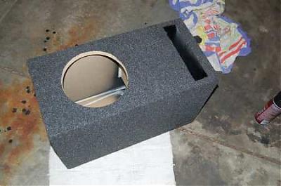

You can't forget about the box. You'll need one to put your sub in ;). I would recommend a ported box and running a 10" sub like Mat suggested. If you decide to go to your local audio shop and pick up a prefabricated sub box, you might as well not even waste your money on subs. The sub box is the most crucial part a system. It can make the 'best subs in the world' sound liek crap without the right box. Once you decide on a subwoofer, I and others can help you figure out a box that would suit it the best. I build boxes and would by happy to assist you. I just sold my 10" sub box today, but can make another one if you're interested. I'll post pictures of it so you can get an idea of what it would look like. I can probaly build one similar to this for you for around $95 shipped. It would be ported, carpeted, and I can instal terminal cups for you. Good luck, and let me know if you have any additional questions.
