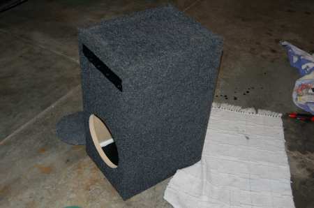

Username: Cried
Erie, PA US
Post Number: 230
1.25 Cubes @ 32 Hz = T3h $h!t
$80 shipped, I know you're all tired of seein this damn box.. SO SOMEONE BUY IT, SH!T!
