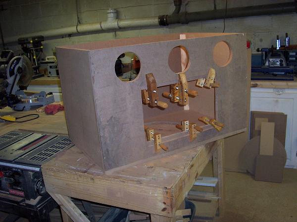

how did u secure the plexi-glass inside ur HT box?
A pic is worth 1000 posts!!
Post Number: 5981
Generated a channel using pieces of MDF and sat the plexi on that. Screwed it in tight and used plexi adhesive with an aluminium channel around the perimeter. It's not going anywhere.

when you screwed in the plexi it didnt crack it?
Post Number: 5986
Predrill and countersink your screw holes. Take your time and use adhesive. There's less pressure on the walls if it's a vented box. The aluminium channel I used was just an added feature. It's simpler to just attach the plexi to the rear but you see that all the time. I wanted to be different. I also wanted to be able to easily remove the window if I had to.
