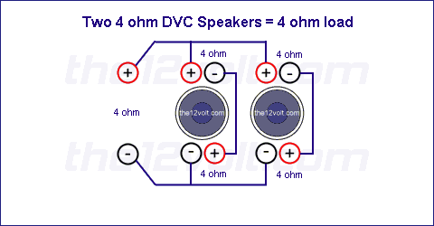

since u said ur subs r dual 4ohms then wire it like this to ur amp
Upload .....

The way Rovin showed is the way you have them wired, unless you have the coils AND subs in series, then you're getting a 16ohm load, which is too much. That amp should push them really well, my friend has 600W pushing them and that's all they needed - it's a sealed box. Either something's not right with the wiring or your expectations were too high lol

yeah thats how theyre wired. maybe ur right and my expectations are too high. i mean they do hit hard it just threw me off because when i had the 2 ohm dvc subs and had them wired exactly the same way they hit harder than these. but that wouldve messed up my amp because my amp isnt stable at 2 ohms bridged.
so the way they are wired right now each sub has an 8 ohm load right? hows 2 of them equal 4 ohms altogether?
