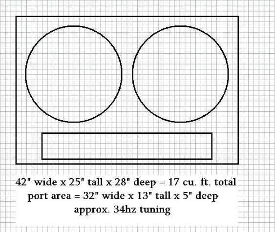

so this is the one im using to replace the TTB t-line enclosure.
same design i already had that chad lee helped me with but i decided since the port would be about 3 inches from the hatch panel i would move it to the top with the subs. the port will be on the back wall by the hatch panel.
and a few recalculations later and this is what i got.
both deminsions listed are with the box sitting on its actual bottom.

thats cool. just make sure you use the wall of the box as one side of the port. meaning don't have that space between the port and the end of the box.

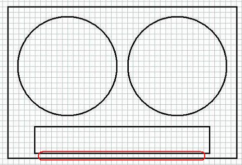

are you talking about the part circled in red chad?
if so, that is the back wall towards the hatch panel. 3 pieces of wood is all i will be using to make the port, the 4th piece is that back wall...

yea tremor that is what i am talking about.

cool, yeah, that is the back wall. it would be pointless to make the port like an inch from the wall, more work for nothing. haha...
