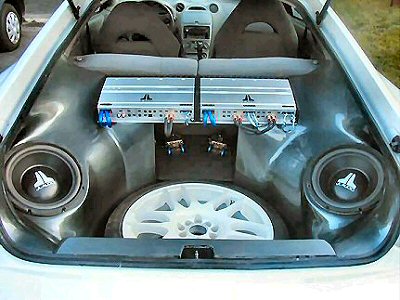

You can use fiberglass for custom shaped boxes, just not clear.. you can add gelcoat to the 'glass though to custom color the stuff to match the car trim though. Here's a box design for a Celica done in fiberglass, similar to the design I'm planning to use in my own Celica when I buy it.
