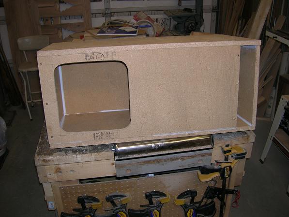

OK...well I am finishing up my first ported box for an L7, just so I have some practice for this summer. Lemme know what you think. I still will do a little more work to it, but it's about done!Upload

looks good but what kinda wood is that? looks like particle board.

^^^ i was about to ask the same thing
looks good thus far
yeh it does look like chipboard to mee too .....

To be honest I am not sure. i asked for MDF at Menards and they said this was it. I thought particle board was the stuff that looks like chips of wood glued together?

thats plywood lol. you definitely have particle board...

well sh!t...oh well, I'll deal with it for this box, I am not too woried with one L7. I will make sure I get the right stuff this summer when I upgrade. Just for the future, what does the MDF give me that the particle board does not. Performance, looks, sound, etc?

strength

OK...well this is the same stuff I have build boxes out of before, so I am not worried. I will just look out for that in the future.

Are you planning on carpeting it? It will look better, and give it more strength if its tight.

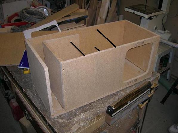

brace that thing. put some rods or a few piece of 2 x 2's. kinda like on this picture.

OK...that's easy enough to do. I asked about bracing when I was talking about making this box and someone (don't remember who) said that L7=no need

nahh...l7 will sweep alot of air and it really is a powerful sub so i would agree with bracing

you also have to take in to consideration that your box is made out of particle wood. it would flex more than mdf.
A pic is worth 1000 words
Post Number: 4720
Yeah brace it up. Looks to be a tight job if you've already closed it up, and it looks like you have. Are all the sides glued up?

IMO - whenever possible even on a small box its a big advantage when a box is braced ,the energy saved from vibrating wood will then go into more output 4 ur music
it does make a considerable difference
from the pix i will say u def got a chipboard looking material since mdf is more compact & u dont see like the texture - but hey no harm since i seen ppl use reg plywood & still sounded decnt enough ........

Yeah I figure it has to be better than plywood. And as for the bracing, I will see what I can do. The top is only screwed on (the rest is glued and screwed), but I put a caulk bead on the top so that it would seal up nice and tight. So I will probably try to get in there through the cutout. If I can't and something happens, oh well, this whole box is just a learning experience anyways.

oh, just router the ends of the port.(hard angles) if u missed that. helps with FLOW...
