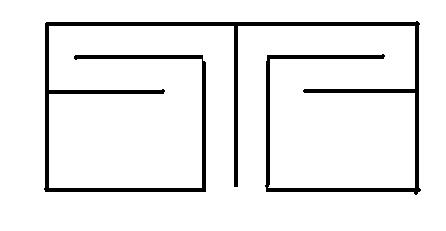

a couple more things...if i mount it with the magnet out do i have to reverse the wires or something?? Someone told me that not sure how true it is...also i wanna make my box like that pic but what would the actual measurements be???

to add to waht rovin said, if you use 1" it will take up more space and give you less net volume...using the same designs as one with 3\4" that is... if you plan for it to be 1" the only things there is finding the 1" mdf (not the easiest to find) it will cost more... but the only good side about it is that it is going to be alot stronger of a box. I used 1" birch and oak on my last box and it cost me about 150$ in wood and supplys.. really strudy..but overkill lol
