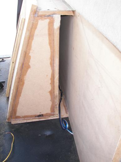

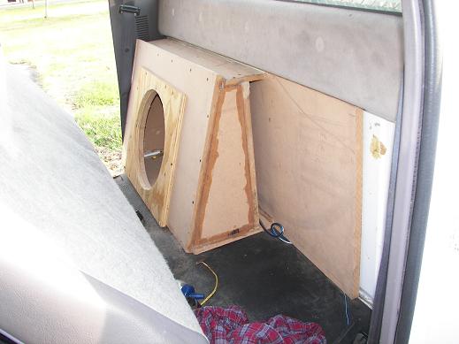

Gold Member Username: J_baby15Kentucky Post Number: 1233 Registered: Feb-06 | if its built well it will sound very good. tune in the mid to low 30s and it will sound nice. Heres one i built. Looks rough in the pics cuz it was jus put in for fittin, and we ran outta MDF for the double front thats y theres plywood there. Edges hadn't been sanded yet either, but u get the idea. this was for 1 15"SSI tuned to 32hz. sounded very good, far better than sealed. ![]() |
Gold Member Username: Matt12490California USA Post Number: 1653 Registered: May-05 | i still dont get how that thing is for a 15 sub. how much volume does it have again? |
Gold Member Username: J_baby15Kentucky Post Number: 1239 Registered: Feb-06 | about 2.3cuft., i forgot the port space tho. Sounds very very nice tho, wish i could get sum new pics with it actually looking nice one i fixed the front, sanded, and painted over it(I suck at carpeting). Still didn't put in a terminal either, we jus left the wire runnin out the port. |
