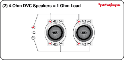

You should only have one set of wires running into the amp. did you you hook up wires to both speaker terminals and run both sets to the amp? If thats the case the subs are not wired correctly. I believe your amp is 1 ohm stable so it should be wired like....Upload

You are correct it is a 1ohm stable amp. I did not wire it like the diagram (slightly off). I just wired it exactly how the guys that installed it did (I drew down how they did it before I removed them)
I can't find a diagram of how I did it online, so I will do my best to explain.
I have TWO sets of speaker wire (each with a + and - lead). Sub on the left has + and - terminal, as does sub on the right. [I have done the followed for both subs]: I have taken one speaker wire, split it at BOTH ends, attached one part of one end to the - terminal of the sub, the other part to the + part of the sub and ran the ends of the speaker wires towards the amp. From here, I have taken the + ends coming from both subs, twisted them together, and inserted them into the + input on the amp. I did the same with the -.
So its similar to the diagram you posted. But they used one speaker wire and split it to go to both + leads on the sub, then just twisted that wire and stuck it into the + (same for negative). I did almost the same thing, just used the + and - parts of the two different speaker wires and twisted them together....
I hope that made sense.

Now that I've looked at that diagram it looks easier to just wire it that way. Since speaker wire comes in a pair... my question is this:
So I take the speaker wire, split it at one end and run each end of the split into the + terminals for the subs. Then I take the end of that wire, twist the ends together, and stick them into the +? Is so that seems easier and I will try it.

Ok this is probably the worst drawing I've ever done, but I hope this helps. The speaker wire represents black, where it has been split I drew in which parts of the split represent + and -
This is how I have it wired:
That is the worst drawing ever. But its how they installed them. The only thing I'm at a disadvantage is that I can't see how the subs are wired inside the box unless I take them out. Hope that helps.

that's correct^
