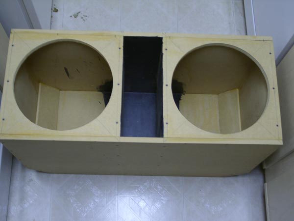

Well its done.. minus the resin for the corners.. double baffle and port insert.. but yeah here it is.

hows it look in the car???
Username: Jblanford
Post Number: 345
it prolly doesn't fit lol
Username: Jblanford
Post Number: 346
but it looks great

yea.. hopefully it fits lol if not i guess ill sell it.. won't know till this weekend :-(
and btw.. the rotozip is my best friend when it comes to cutting holes.. i sued to use a jigsaw but not anymore.. comes out much cleaner and easier with a rotozip.. i was suprised how good they can out without using a guide of any sort :-)

do you cut your wood or you go to lowes and let them cut it for ya????
Username: Frkkevin
Post Number: 2803
I had home depot cut two pieces so i could fit it in my car.. and well both cuts were an 1/8" off.. so i don't suggest getting your wood cut there :-)
the sad thing is i watched the guy double check the measurement
other than that i used a basic ole skilsaw

I have to build my boxes with almost no equiptment feel lucky.... i have a jigsaw, a power sander (which is to big to fit in alot of places) and then a skill saw... thats all.... its sorta a pain because of how time cunsuming it is to make sure everything is straight.... and Jack... thats why you tell them to cut it a little bigger then you want :-) but its nice, did you carpet it? and those r the 15's right?

yes they are 15s.. and no i did not carpet it.. i have another plan which ill will port after i get it in :-) hehe

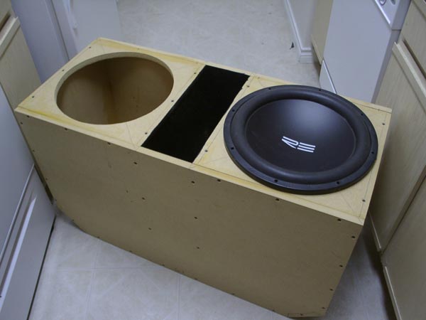

Nice box....What are the Specs for it?
Username: Frkkevin
Post Number: 2805
In short..
Type: Vented Box
Shape: Prism, square
Vb = 5.457 cu.ft
Fb = 45.17 Hz
F3 = 39.64 Hz
Fill = none
No. of Vents = 1
Vent shape = rectangle
Vent ends = one flush
Hv = 15.5 in
Wv = 6 in
Lv = 15.75 in
And yes I know it is a little small for 15s but I had to build the box to fit the trunk, not to fit the subs.. still gotta build the drop in port to tune down for daily

Username: Frkkevin
Post Number: 2811
the plus is ill have more cone control given im using more power for the subs anyway.. and boxes that are tuned higher work fine with smaller enclosures...
i just hope it sounds decent daily tuned to 35-36hz :-)

little resin work today.. damn these corners are getting round :-) .. from two 45s to three 30s

do you need to put resin in a box?
Username: Frkkevin
Post Number: 2824
no.. but it seales the pores of the box making the air flow more freely with less drag..
it also adds strength
in my case im just using it to strengthen the joints where the 45s are and to help rounding off the corners even more
