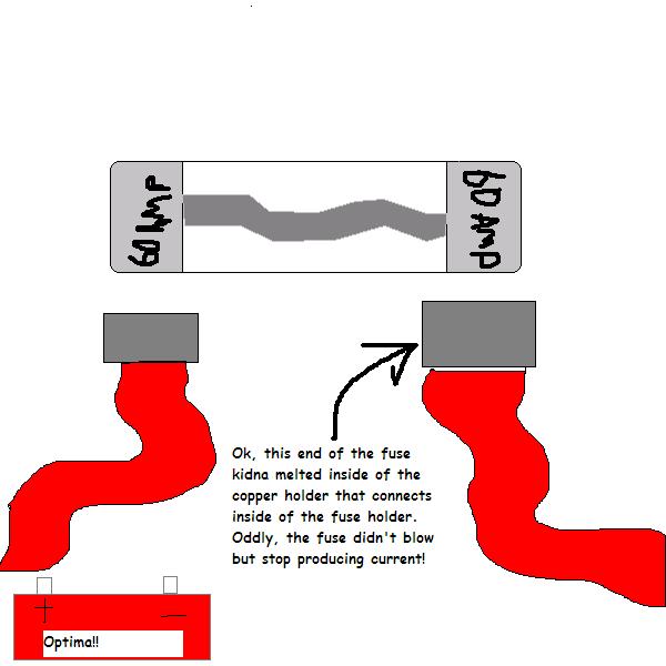

Ok so after some deep investigation of all my wires, connections, and even opening the amp...I got it solved. Like I said earlier, I checked to see if the fuse had blown on the in-line fuse holder and it didn't...BUT, I never took the fuse out to examine it, until just now! lol Anyway, I discovered that the one of the fuse's end had kinda "soldered" itself into one end of the fuse holder. Note, I had the glass cyclinder fuse holder with a 60 amp fuse inside. Soo, I took that off and tried powering it directly to the battery and TAA-DAAAA... I'm bumping again! lol I'm going to bump it until Friday, I'm going to buy an ANL fuse/holder!

No NO No, lol there WEREN'T ANY fuses blown. The fuse that was in the fuse holder had kinda "soldered" itself inside of the metal holders. The metal ends on the glass fuse had melted inside of the damn thing. I don't know if that cleared anything up. I'll draw a pic in a few! lol

Here ya go Rob. Sorry for the half @$$ explanation I gave! Hope this helps!Upload
