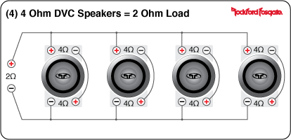

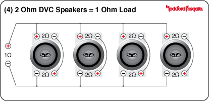

Silver Member Username: Teddy21Ann Arbor, MI USA Post Number: 336 Registered: Feb-06 | IDMAX is a great choice!!! and the Focal components are the best you can probably buy! for amps you need to match the RMS of the subs to the RMS of the amp (and for the components) you need to know what ohm the subs will be wired to in the end to determine how much power is going to be comming out of your amp. these diagrams show you how exactly to wire the subs to get the desired ohms. ---for 4 2ohm dual voice coil subs you can wire to 1 ohm or 4 ohm but this is the 1 ohm diagram ---for 4 2ohm DVC subs you can wire to 2 ohm or 8 ohm but this is the 2 ohm diagram im not sure what exactly the IDMAX's can handle, power wise, but your probably gonna need like a amp that can produce 2000 watts at 1 or 2 ohms. there are alot of choices in amps but some of the best companies for good sound are zapco us amps <--- older amps are great McIntosh jl audio <--- great choice sinfoni tru amps xtant arc audio Get a Class D amp for the subs and a class a/b amp for the components go here, this lady will tell you all about it...lol http://usamps.com/ |
