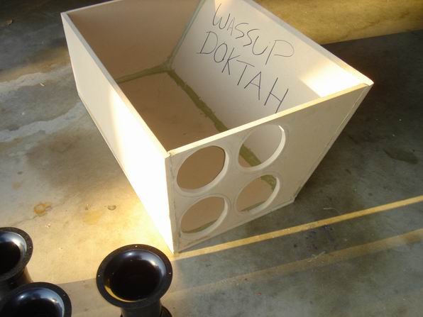

it will be done tomorow. i just thought i post some pics first.

whats that tuned too? how many cubes

6.8 cuft net and it will be tuned to 40hz. for daily i will plug one port and the tuning will change to 34hz.

Whats up with the trapazoidal shape? Thems ports are shorties tuning high? Polo..

yeah for real thats what i was wondering 35hz is usually like 13-14 inches long each port for that size of a box

yeah i am tuning high polo.
those ports are 10 inches long.

like i said spl choice, if i plug one port the tuning will drop.

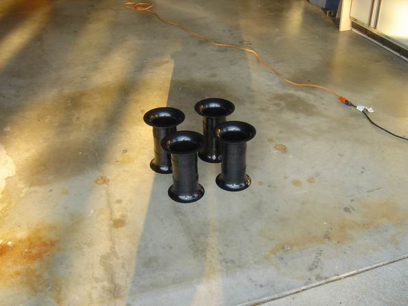

interesting - so thats roughly 50sq" of port area if checked as 4" reg pipes
hope u have plan 2 seriously brace the internal walls of that box cause its looks like its gonna flex like crazy
? - how far from the side of ur car will those aeros be ??????.....

Nice progress Chad. I do see a chance of flex myself, especially on the side the aeros are on. Maybe should have spaced them a little further apart? 150db here we come!Upload

i couldn't space them any further apart. those things flare out to 6 inches.
i have about 8 inches betweent the side of my car and the side of my box. maybe little less. if it don't work out i can always build another box. i love building boxes. lol.

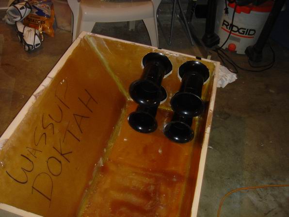

hey guys i just applied the first coat of resin. should i have left the garage door opened when i was doing that. i feel kinda dizzy right now.

lmao, don't tell me you didn't get a respirator! LMAO! So how did you apply the resin? did you brush it on, pour it in, lay in fiberglass matt, then brush resin over it. or what? just wondering =).

what fiberglass mat? i thought you just pour it in the box and lightly brush it to even it out.
i am gonna get the fiberglass mat for the side walls though.

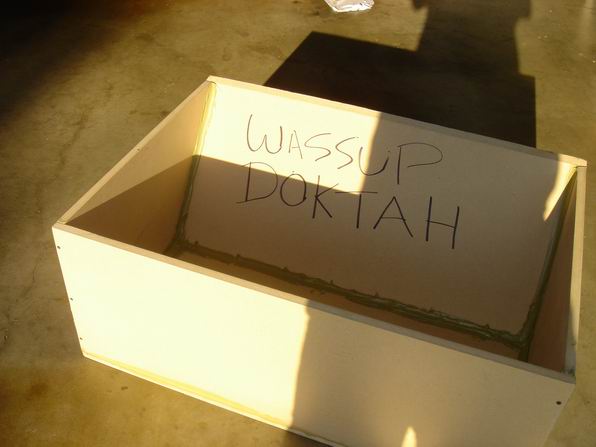

your going for spl right?? put some bonde on the corners and make it like rounded corners to make the airflow better will gain some spl :-)

Fi AudioBTL
Post Number: 8322
here is a progress pic. i was working on other stuff so i couldn't get much done. i did resin it.

i had to make it trapazoid so it will fit perfectly in my car. it may look sharp on the outside but i rounded that corner with resin. just pour it in there and let it sit.

hey I would diffently matt the sides of the boxes with fiberglass matt, then soak them with resin, and smooth everything down glass slick with a sander, the entire inside of the box! that resin should be slicker than glass then!
box looks good, but u need to make it stronger, I would put about another 2gallons of resin in there!
if u hit your score and decide to keep the box, I would also resin the outside, sand it smooth, clean, paint it your factory black color of your car code, and shoot some clear coat on that b!tch! then that will be a pretty MF box!!
I did 1 similar to that for about 1200$$

yeah i put 3 layers of fiberglass mat on the part where ther ports are and one layer on the other walls.
with the high tuning and the fact that my subs will be in the same chamber, i am hoping for a better number.

Hey Chad there is another trick to getting rid of the corners. Use Great Stuff, yes you heard me the expanding foam. Take the supplied tube go downt he center line of the cranck until the corner is full. The use a putty knife to give shape, I prefer flat that stuff can be sanded and filled, even resin over it. The key here is to use it as a filler, costs less, weighs less and absorbs sound waves due to its porous nature. This stuff also bonds to just about anything and can be removed later if you wish. Polo. :-)

very nice idea. i am gonna do that on my next box. that is if i don't hit 150db with this one, i am building another one. i am gonna do that to all the corners of the box with that foam stuff. after foaming the corners, i can just brush some resin over it to make it even smoother.
unfortuanately i put the top on already so i can't do that to the box right now. also i made a littel mistake of putting the sub cutout too close to the edge so i really can't get rid of the corner near there.
to get rid of the sharp corner, i stood the box up on that coner and poured alot of resin on it and let it sit.
