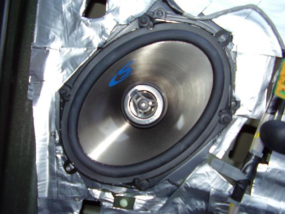

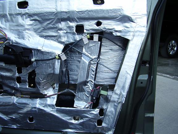

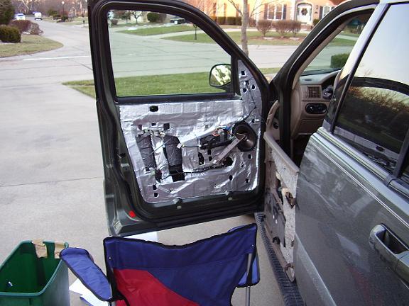

Sunday, December 10, 2006 - 18:35 GMT Put down 3 layers of Edead on the front two doors yesterday...heres a few random pics.

Sunday, December 10, 2006 - 19:40 GMT its the v1s^2. it is extremely easy to put on. just make sure u have an exacto knife and a good roller. it took me about 3 hours to do all three layers but getting the doors off on mountaineers takes a good 20 min, so any other car should take closer to 2-21/2 hours. i put the type S speakers back in and the rainbows out because im changing speaker amps...little change in sq to say the least. part 2 of the install is 2 layers on the back doors, 4 layers on back hatch, and 2 layers under the box. part 3 is the headliner. part 4 (if i have enough left) A and B pillars.

Monday, December 11, 2006 - 04:25 GMT i got 180sqft all together, and i used almost a full roll (30sqft) on the front doors. its about 5sqft per layer.
