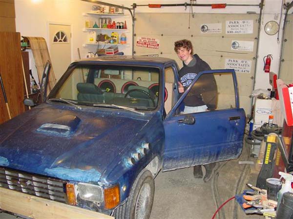

Gold Member Username: Extrmndor3Im pushing i... And pushing ... Post Number: 2805 Registered: Feb-06 | why not try both??? ask who made this set up he got both of them and it looks like he can hit the lows pretty good. ![]() ![]() ![]() yay with these two set up forget about steve meades, they are gonna b@ng him like a noob. |
